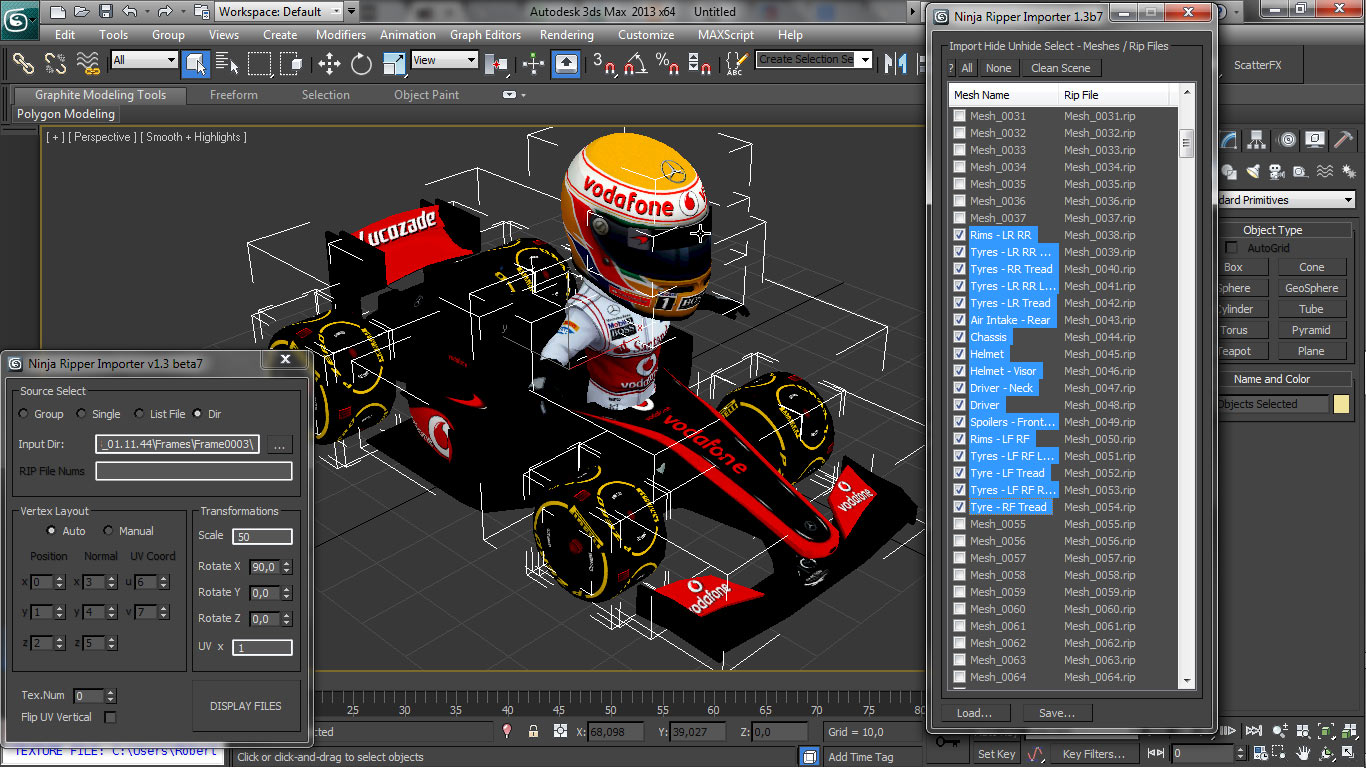

A big thank you for this wonderful tool.
I have one burning question.
When I ripped the meshes, the driver was sitting in the car.
Now he is standing with his arms spread.
How do I also rip the bones and animations of the models?

Robert писал(а):A big thank you for this wonderful tool.
Where did you get the importer that has "dir" button? at the top?
#743 Сообщение Tosyk »
Robert писал(а):How do I also rip the bones and animations of the models?
you can't, any 3d ripper would rip original models.
videoadapter rendering only veretices/triangles and not animation/skeleton/bones, so you can't rip what don't even exist
Dainius писал(а):Where did you get the importer that has "dir" button? at the top?
he probably made it, by himself

#744 Сообщение Robert »
Apologies for the delay. I forgot to remove the Hotmail email address. Email from this board does not reach my Hotmail inbox.
I will do so right after this post.
Dainius писал(а):.....
I did.
Short : I do not work on it anymore. Because MAXScript probably has the worst documentation in the universe.
If the developer of Ninja Ripper allows it. I could upload the modified importer, and new listview MAXScripts as an attachment.
But I need to clean up the code a bit first. Let me know.
Long :I do not work on it anymore. 2+ weeks ago, when I discovered Ninja Ripper, I had never programmed in MAXScript.
I wanted to see all the files in one "Frame...." directory in a list so that I could easily check and select.
I decided to extend Ninja Ripper, because it was a good opportunity to find out about MAXScript.
But because of the inaccessible and bad documentation it took me almost 2 weeks to get it to where it is now.
The person who wrote the documentation probably has his own MAXScript tutorials and wants you to buy them.
It feels like it's deliberately made inaccessible and incomplete.

Of course. That makes sense. I'm ripping the output only. To get what I want, I need to dig in the game data.
