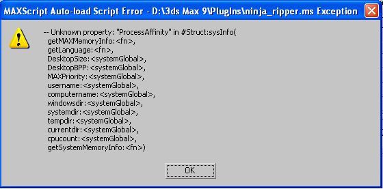

Tosyk писал(а):если есть желаение проверь скрипт бета2 на всех максах, которые у тебя есть
В 7 и 9 не работает (сразу окошко с Unknown Property.. бла-бла-бла), в 2010 нормально, только единица вылазит при импорте пачкой, в 2012 специально проверять лень (редко 7-ку загружаю), но при случае проверю, хотя думаю что все ок будет.

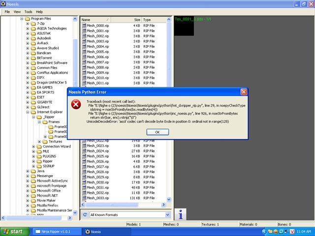

i don't know, i had turned off injector and close IE, then log in again but auto-dis :|, but the first time i can log in. so i think not due to firewall or antivirus. and i tried .abc in noesis too, but fail :( My friend send sample file abc to finale but he said he couldn't know structure of that file :-?

onelove1210 писал(а):but i don't know why use Ninja Ripper can rip, but old DX ripper can't
because noesis can't read new .rip format (from ninja ripper), it can only open an old .rip files (from dx ripper)
for convert .rip files u can use 3ds max 2009 and above

Tosyk писал(а):for convert .rip files u can use 3ds max 2009 and above
there is no point to update noesis plugin right now, because development of .rip format are still in progress
I use 3dsmax 9 and i don't know about Max, did Max9 different from 2009?
