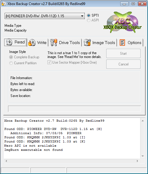

2. Run the program Xbox Backup Creator:

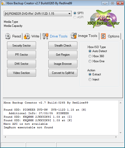

3. Click on the tab Image Tools, appears:
4. Next, click Image Browser:

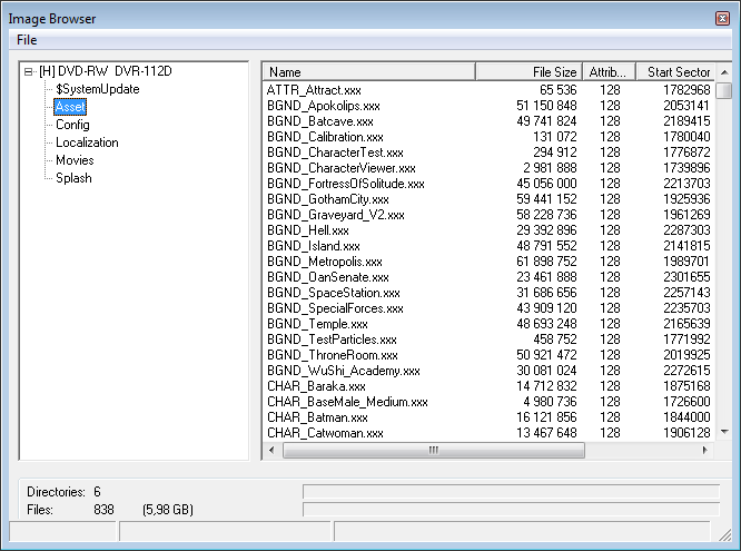

It’s a browser of what is on the disk, there are videos and files (in the Asset folder):

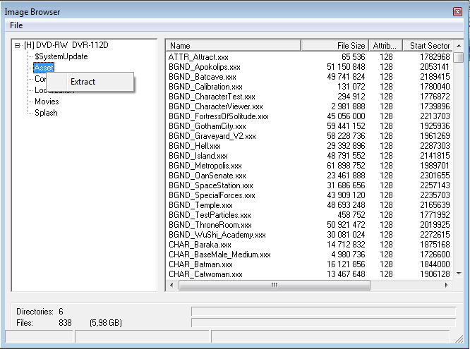

5. You can export the entire disk by right-clicking on it, and then Extract:
as well as separate folders (or files):
