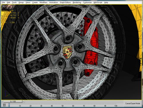

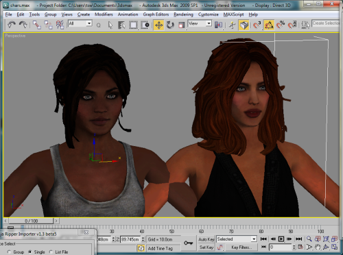

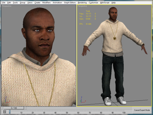

5. Results. Here’s some results of the game’s rips Battlefield: Bad Company 2, Battlefield 3, NFS: Run, Expendables 2:
